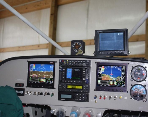

I had to wait for the wing to be installed and the rest of the wing root wiring connections to be done before running the infrared cable into the panel and finalizing the video and power connections. The system is powered up by a microswitch which is activated by lifting up the monitor.
Harness wired in place.
Flip up monitor showing infrared image
