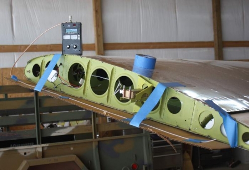

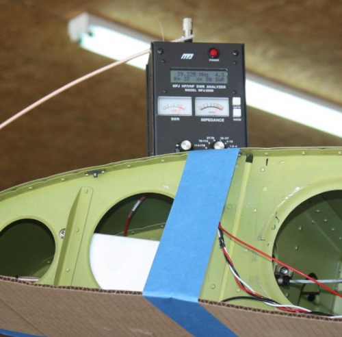

I rigged up a temporary cardboard wingtip and fabricated a Bob Archer-style marker beacon antenna using RG-400 cable. Bob Archer recommends a 40 inch section of exposed ( insulation only) conductor, but I wanted to optimize the antenna within reason so as to hopefully only do this once. Accordingly, I set a SWR meter initially to 75 Mhz, and then adjusted the frequency until minimal SWR was found. I multiplied the ratio of the low SWR frequency divided by 75 MHz times the initial antenna length, and found that 27.75 inches was a more optimum length than 40 inches on the Bearhawk. Further optimization would require glassing the antenna and then rechecking, then probably trimming some more with a dremel tool as fiberglass effects the SWR, but that would have required considerable time and effort, and I figure (and hope) this is close enough. I then temporarily fixed the antenna in place using tape, spot welded it with 5 minute epoxy, and then glassed it in place with two-ply and epoxy resin. I then left enough cable for a service loop, and placed a BNC connector which will mate up with the outboard rib BNC connector.
Cardboard wingtip and initial antenna in place.
SWR meter.
SWR meter.
Marker beacon antenna epoxied in place.
