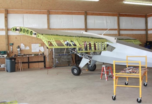

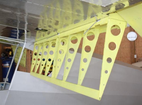

I mounted the left flap. Unlike the ailerons on this side, the hinges tended to be mounted low on the doubler, supporting the idea that there should be less spacing on the hinge mounting, so that the hinge mount drill holes aren't so close to the edge of the doubler.
Flap support bearings.

Left aileron and flap mounted.
