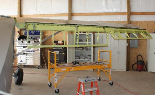

Brief Description:  Right Flap and Aileron Support Bearings and Mounti
I removed the flap and aileron support bearing tubes, and drilled them with a #20 drill bit to fit a pair of 5/32 x 1 inch AN470AD rivets. After drilling one hole, I used a cutoff rivet shank to pin the bearing in place, for fear of the Superglue letting go after the vibration of the drilling operations. After riveting the bearings in place, I reinstalled and torqued the flap and aileron support tubes and mounted the right flap and aileron.
Drilling support tube.
Riveting support tube.
Installed flap and aileron.
