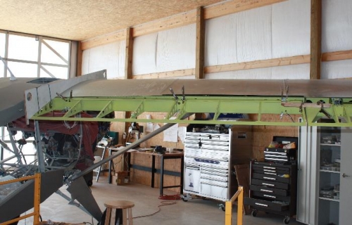

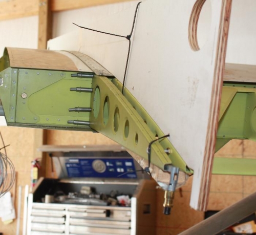

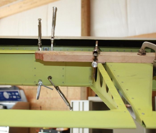

I adjusted the flap positioning to fit the already provisionally installed aileron; I used a pair of 3/16 inch bolts and bushings to maintain the 1/2 typical spacing as well as fore and aft positioning. I clamped the upper flap to the aileron outboard, and used the wing template inboard. I used Superglue to temporarily hold the support bearings in the proper positioning prior to drilling them.
Overall positioning.
Flap - Aileron clamped with bushing.
Inboard flap with bushing and template.
