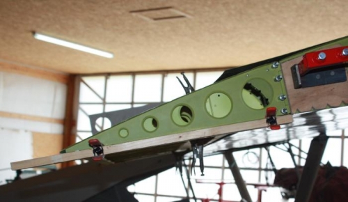

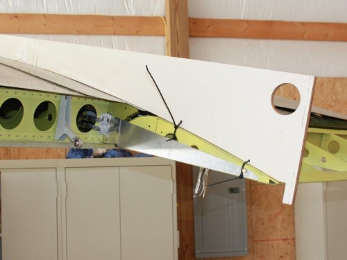

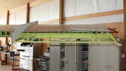

I think the wing control surfaces are tricky to mount. You can adust up and down, fore and aft, left and right, without a lot cues as to where the right place is. Fortunately, the outboard rib, which also intefaces with the wingtip, comes pre-drilled, and presumably matches the desired contour. There are also keying holes on each rib and control surface. I made a temporary rib to reproduce the keying hole position of the outboard rib, and clamped it to the spar at the aileron position inboard. This enabled me to define the fore/aft position of the aileron and at least the up and down position of the aft aileron. I used the plywood template to define the forward aileron contour, and made a 0.5 inch bushing to lock the left/right position of the aileron relative to the outboard rib, as described in the plans. I clamped the aileron hinges to the aileron spar after removing the gussets, and Superglued the aileron bearings into their tubes so as a provisional means of fixing their position prior to riveting. I ended up making a small transfer punch on the lathe so as to mark the spar where the hinge holes would go, and drilled same.
Outboard rib.
Outboard rib.
Temporary rib clamped in position.
Overall positioning.
