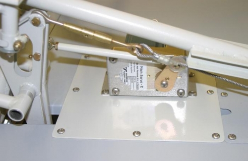

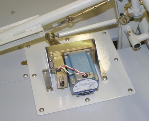

Brief Description:  Autopilot Pitch Servo
The TruTrak pitch servo was installed beneath the seats; a .063 8 inch square doubler secures the servo to the floorboards. After discussion with the factory, I'll probably end up putting the roll servo overhead using a capstan attachment to the aileron cable carry-over like on Mark Goldberg's aircraft, as that installation is out of the way and makes for a fairly clean set-up.
Left side
Left side
Right side
Right side
