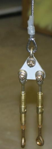

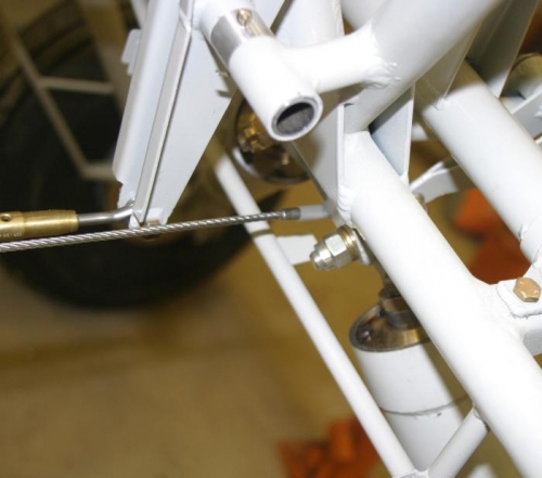

Brief Description:  Flap Controls 2
I changed over to a swaged fitting at the flap lever cable attach point, and ordered turnbuckle forks, which didn't come with the Wick's hardware kit, so that the turnbuckles can attach correctly to the Avipro "triangle". The forks were set to size .25 inch holes, so I made bushings so that they would fit up to the triangle, which has 3/16 inch holes, and not enough center-edge distance to allow drilling out to .25 inches.
Swaged fitting gives more clearance
Turnbuckles
Turnbuckles
