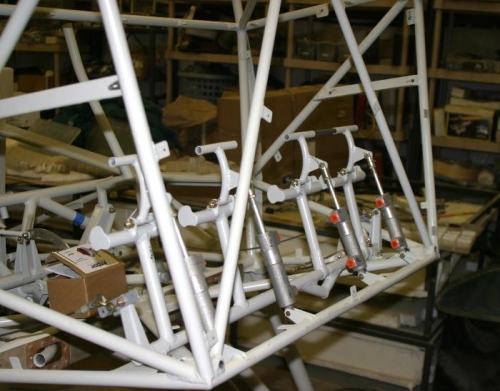

Brief Description:  Rudder Pedal Install
Rudder pedals and brake cylinders installed. I largely used clevis pins as they are simpler and lighter. A short piece of 3/8 aluminum tubing has been temporarily placed in the brake pedals on the left in order to keep the pedals centered for installation of the cables.
