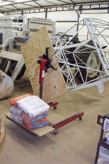

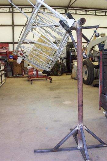

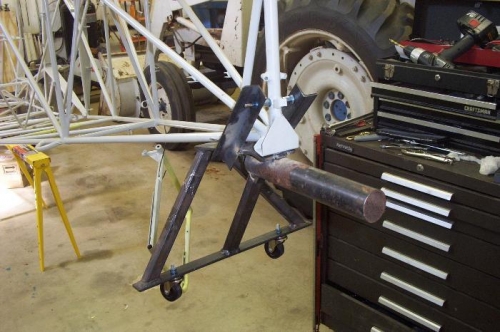

Brief Description:  Fuselage Rotisserie
Used a Harbor Freight Engine Stand to fabricate a rotatable stand at the motor mount; I cut the vertical support in two and augmented it's length with some old pipe. It was necessary to counterbalance the fuselage with a platform and three bags of mortar, which I had laying around. I made another stand for the tail, incorporating the Avipro rear fuselage mount, utilizing some old fence pipe and some rectangular stock I had laying around from another project. Bushings were made of 5/16 in couplings so as to provide three point fixation of the tail mount. This rotisserie should make it easier to weld and install components on the fuselage. All welds are farm quality!
