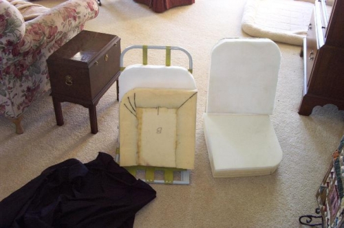

Brief Description:  Seat Cushions
Bottom seat cushions were fabricated from 1 inch firm, medium foam and soft temperfoam glued together with 3M general trim adhesive. On the bottom, an additional 4 in tapered wedge was ringed around the outer seat so as "bolster" the cushion using firm foam. On the back, only firm foam and soft temperfoam only was used. I didn't use a lot of temperfoam as it is expensive and heavy. The current version feels quite comfortable. Fire retardant black canvas will be placed between the seat strips and the foam to protect the foam. The rear seat is similar. I'm going to take the seats down to "Flying Horse Upholstery" at Granbury TX airport to have the actual upholstering done.
