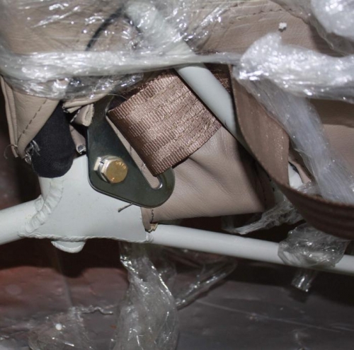

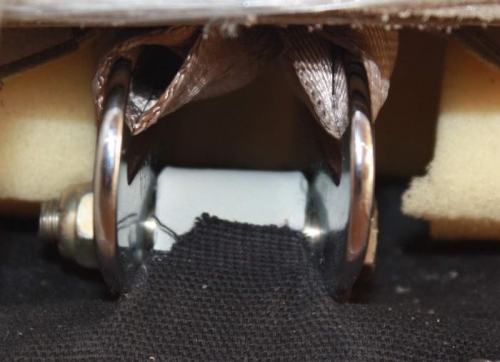

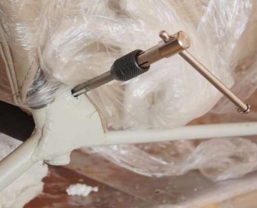

I tapped the outer seat belt mounts with a 5/16 inch NF tap and bolted the outer belts in place. I used an AN4-15A bolt and fender washers to bolt the inner belts to the tube welded in the back of the seat.
Tapping outer seat belt mount.
Installed outer seatbelt.
Bolted inner seatbelts.
