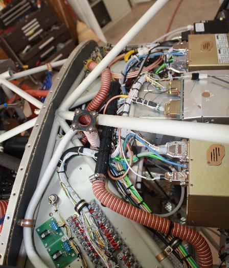

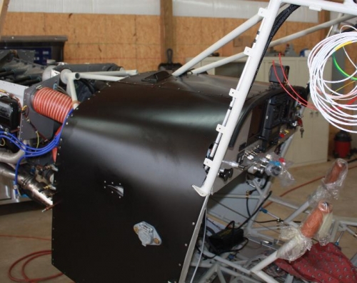

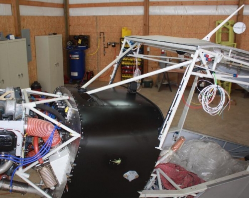

I'd previously painted the inside of the boot cowl, and I went ahead and primed the outside, including the panel overhead access port and defrost diffusers with OD epoxy primer, followed by Krylon semi-gloss paint. I installed the panels using 6-32 nuts and flush machine screws along the front, and 6-32 flush machine screws along the aft edge, using the previously placed nutplates. I sealed the front seam from the engine compartment as well as the upper panels with red high-temp RTV, to protect from engine fumes and rain, respectively. I hooked up the external power socket and the 1 inch outside air NACA duct to a diffuser made from 1 inch thin-wall 6061 tubing, to which I TIG-welded a 3003 cap on. Staggered 3/16 inch holes direct the outside air to the avionics stack. A nylon mesh was placed around the tube to provent wire chaffing. I made gaskets for the defrost diffusers to keep the hot air from escaping around the base using a high temp closed foam. I painted the boot cowl black, as I don't exactly know where the windshield will set on it, and I can just have the black stripped and painted when it comes time for the final paint job.
Outside air diffuser in place.
Upper boot cowl.
Upper boot cowl.
Another view.
Another view.
