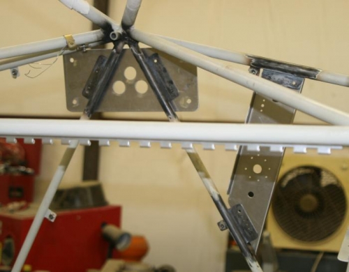

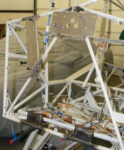

I welded support tabs placed in order to mount doublers for the Electroair electronic ignition coils (which are quite heavy) and for the cowl flap cable and brake master cylinder hoses (which move all the time), and fabricated .063 doublers. I drilled the tabs for nutplate installation.
Front view of welded tabs and doublers.
Aft view.
Aft view.
