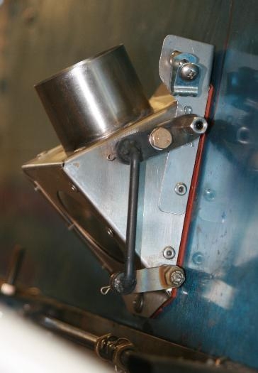

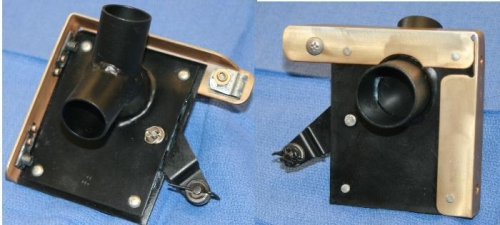

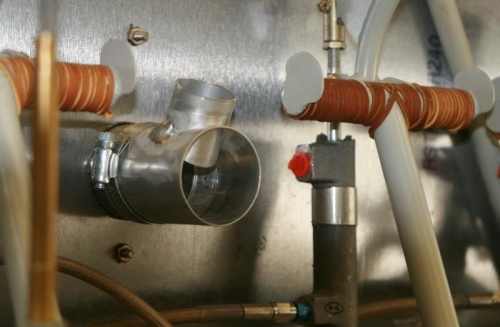

For a heat box, I chose an AviaComp International Tri-Box, which is lightweight, simple and all stainless steel. Unfortunately, I'm an advocate of the heat coming on when you pull on the heat control. As configured, the Tri-Box does the exact opposite, namely pulling on the heat control shuts the heat off. Accordingly, I fabricated a bellcrank to reverse the action using an existing nutplate hole. Inside the cabin, I expanded the inside of a 2 inch 6061 tube with an exhaust pipe expander so it would fit over the Tri-Box outlet and TIG welded a 1.25 inch 6061 tube at an angle so as to catch outlet air for a defroster. SCAT tubing will connect with a salvage Twin Comanche defroster valve to which I fit to some aluminum angle and which will bolt to the firewall with a pair of 10-32 screws. I'll figure out the defroster valve location after all the other firewall installations are done.
Heat Box side view showing bellcrank.
Heat Box outlet with defroster takeoff.
Defroster valve top and bottom.
