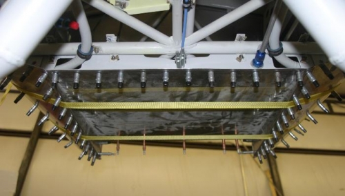

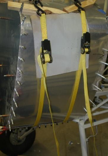

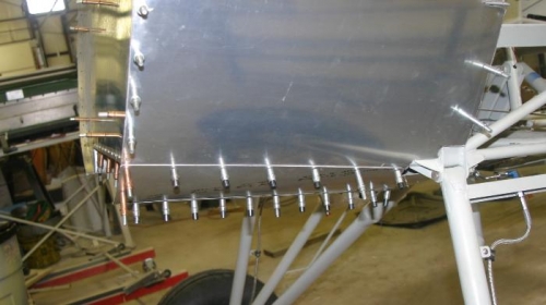

Brief Description:  Boot Cowl 3
More boot cowl; a panel to join the firewall to the cabin tubing, a panel to close off aft of the tubes, and a large panel to allow avionics access as well as two bottom access panels to join with the stainless exhaust tunnel. I'd originally wanted to do a fiberglass panel for the avionics access, but it wouldn't follow compound curves as well as aluminum, so I went with aluminum. The bottom access panels fit best after using a roller to curve them.
