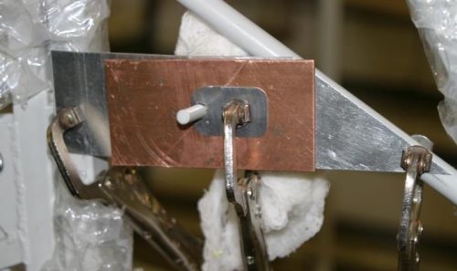

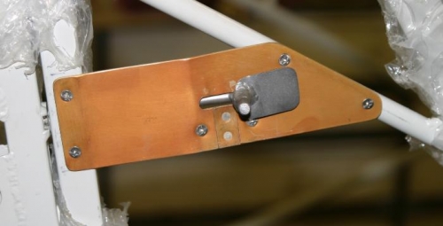

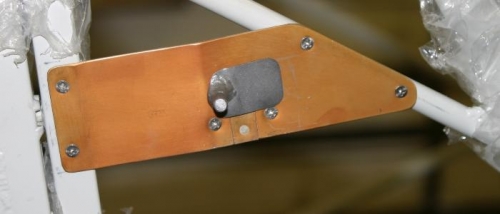

I fabricated a panel and tab which would close the slot which is needed to open the front door, and which would ordinarily pass air in flight. I welded a small tab onto the handle, which parallels the panel. A small amount of space is needed between the tab and the panel to allow for fabric and some Teflon tape to reduce wear; accordingly I used some copper plate to dissipate the heat when welding the tab onto the door handle.
Prior To Welding
Prior To Welding
Cargo Door Latch Closed Position
Cargo Door Latch Open Position
