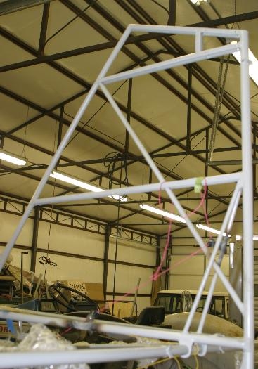

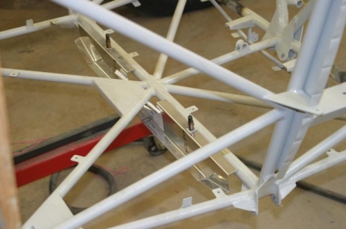

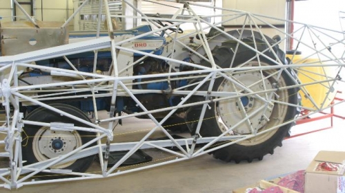

I decided to use two conduits from the aft fuselage to the front to pass all the wires. The left one will carry antenna cabling and the static hose, the right one will pass the power cables to the aft avionics tray. That should minimize any radio frequency interference. There is an aluminum bulkhead from the QB kit at Station B through which the conduit must pass on its way to the nstrument panel, I mounted the bulkhead so as to determine where to put the hole. I welded 9 tabs next to the stringer supports which will mount the Adel clamps which will support the 5/8 in ID 6061 I also welded tabs to pass the VOR cable. Can't go any further as I need more tubing, and a 3/4 in conduit bender.
Left side conduit partially in place
Front bulkhead from Quick Build Kit
VOR Cable Routing
VOR Cable Routing
