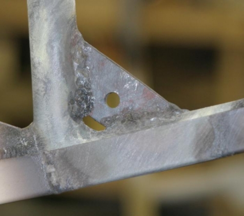

From the factory, the QB kit doesn't have provision for rear shoulder harnesses. I added two .125 in 4130N gussets in order to provide that capability. The location is slightly different on the two sides because of the different configuration of tubing for the cargo door.
Preparing to weld gusset
Right side
Right side
Left Side
Left Side
