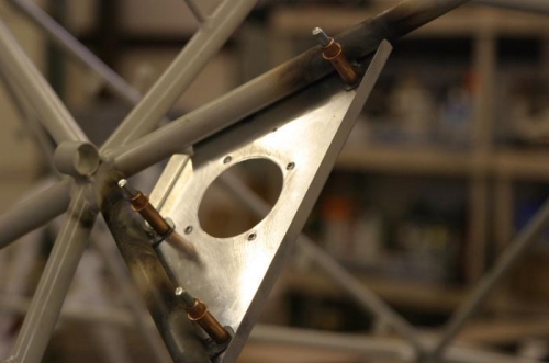

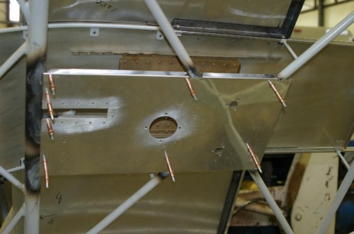

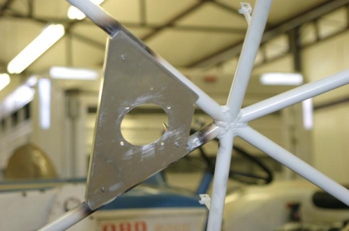

I fabricated front and aft overhead panels. The front covers the trim tab chain and sprocket and provides mounting for a LED dome light and two cockpit lights (www.cockpitlights.com) and related switches and a dimmer. The aft panel only supports a rear seat and baggage compartment LED dome light.
Front Overhead Panel
Aft Overhead Panel
Aft Overhead Panel
Welded Tabs Support Panel
