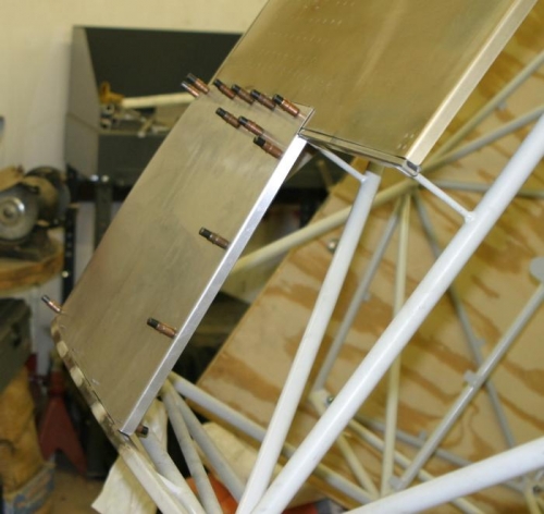

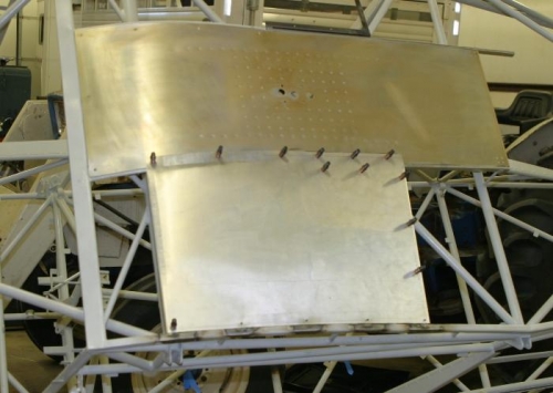

Brief Description:  Skylight 2
I formed this pilot's skylight outer panel from 6061-T4 using a shrinker on the edges, and configured it to overlap the center panel. The other side needs to be done next. After that, bottom cutout frames need to be formed to fit these panels, and the plexiglas formed to fit these panels as well.
Formed with shrinker
The outer skylight panel overlaps center panel
Aft end of outer skylight panel
