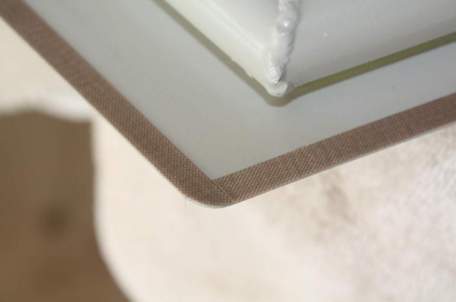

Brief Description:  Door anti-chaffe tape
Now that I've flown 40 hours, I can see the doors, including the engine cowl doors, are chaffing the outer skins. I ordered some 1/4, 3/8, and 1/2 inch .07 mm fiberglass/PTFE(teflon) tape and applied it to the door edges so the chaffing won't happen once the aircraft is painted.
1/4 inch anti-chaffe tape.
