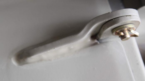

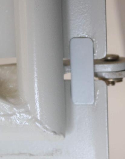

The door skins have gaps to fit over the hinges which likely will result in a lot of noisy air leaks. I cut some small one inch strips of aluminum, alodined them and painted the inside portion and used two-part 3M urethane adhesive to attach them to the inside of the doors. After the adhesive cured, I sealed the outside with paintable 3M automotive seam sealer.
Thin aluminum strips adhesed in place.
3M Seam Sealer in place.
