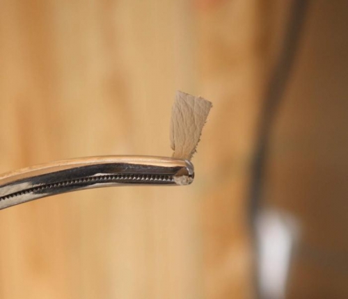

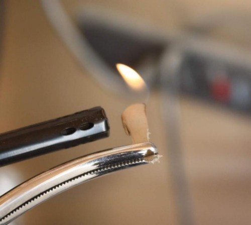

My local DAR wants a burn test on the seat fabric, whcih turns out to be leather in my case. After perusing the various regulations, a flame-resistant test appears the most appropriate. This involves apply a flame directly to the fabric for 10 seconds, and verifying that the flame is self-extinguishing. The leather material passed easily.
Pretest.
Pretest.
Flame applied.
Flame applied.
Charred, but no flame progression.
