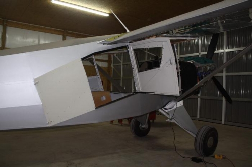

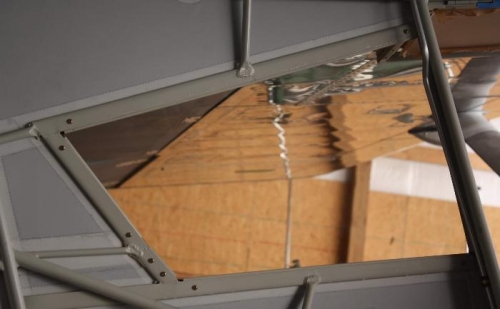

I installed the left aft fuselage plexiglas window. Just as I previously did on the right baggage door, I heated the plexi to about 185 deg using a heat gun and used a flannel covered stick to take the stress off the plastic at the aft angle. I secured the plexiglass using bent over thin aluminum strips with teflon tape against the plexi and a pair of sheet metal screws only on the inner surface. I also installed the baggage doors.

Inside left aft window view.
Baggage doors and window in place.
