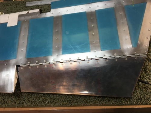

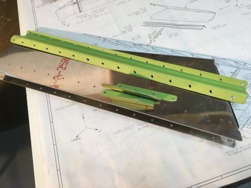

Performed 90 degree bends on trim tab skin. Less than ideal results, so scrapped it and ordered another skin from Vans. Second time around went much smoother. Riveted tab together and trial fit with piano hinge. Riveted assembly and proceeded to trim tab servo.
