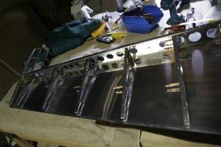

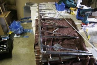

Manual Reference:  7-4 through 7-6
Brief Description:  put together skeleton and fitted skins
completed fabricating the ribs and cleco'd together the skeleton together. Cleco'd both skins to skeleton and cut trailing edge to fit. cleco'd trailing edge to skins. Ready to final drill skin to skeleton.
