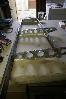

Brief Description:  Riveting together vertical stablizer
Riveted the vertical stablizer spars to the top and middle ribs. Also began riveting the skin on to the skeleton structure. Completed the top rib and middle rib riveting. Also completed the upper spar rivets, which are very difficult to reach as you have to bend the skin and squeeze your arm inside the VS. Once you get the hang of it, it is pretty straightforward, just uncomfortable. I have the lower half of the two spars and the bottom rib left to go on this part.
Ready to rivet the skeleton together

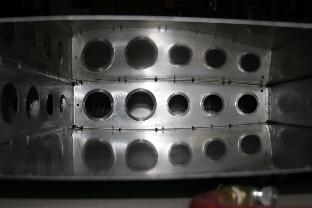

How to access the inside of the VS to rivet the skin to the skeleton

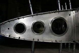

completed riveting nose rib to the skin.
