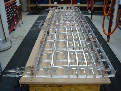

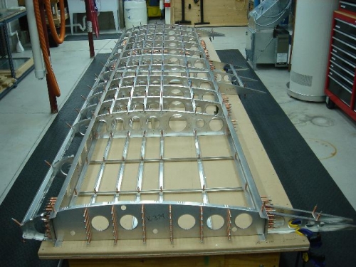

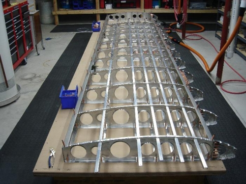

Counter sink right wing top of spar to rib rivet holes, drill key holes in wing parts, inboard to outboard, leading to aft, top to bottom.
