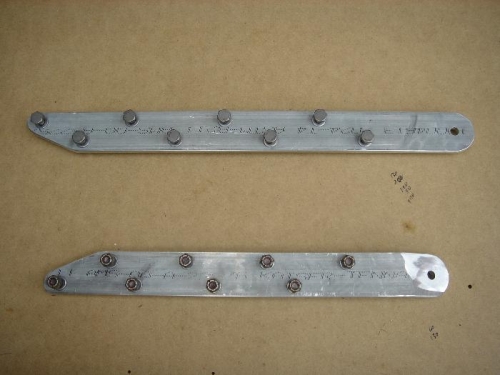

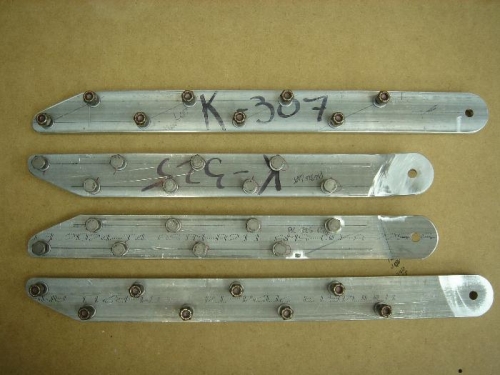

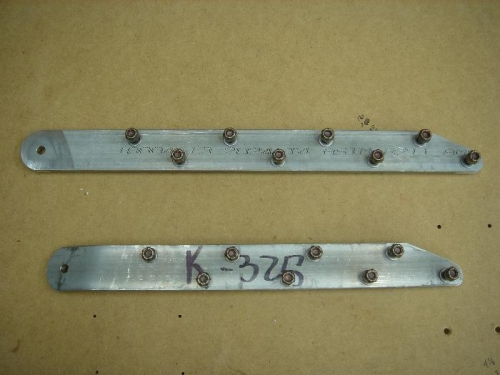

Strut Attach Brackets
Change Main Strut Attach Brackets to spar bolts to AN4C-7A to improve grip length.
