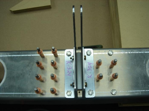

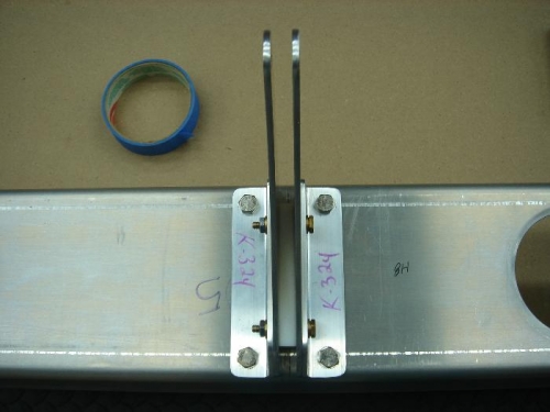

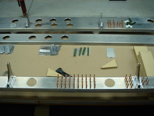

RR Spar Aileron Hinges, Backplate and bellcrank
Locate, drill, fit, cleco right rear spar and backplates for aileron hinges and bellcrank.K-335, K-334 and K-333/332Rivet Spacing for K-335 (X) 32mm (X) 52mm (X) 76mm (X) 29mm (X) 32mm (X) 52mm (X) 44mm (X) 32mm (X) 29mm (X) 23mm (X) 52mm (X) 44mm (X) 32mm (X) 29mm (X) 32mm (X) 52mm (X) 76mm (X)
