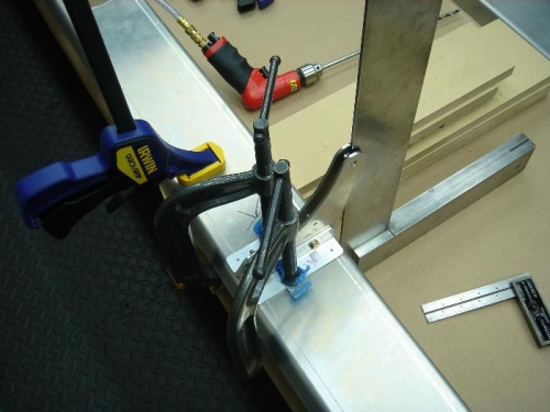

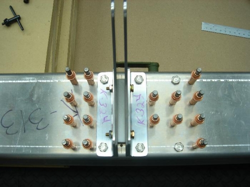

Locate, drill, fit, cleco right rear spar, backplates, flap hinges and bellcrank.K-335, K-334 and Q-500Rivet Spacing for K-335 (X) 23mm (X) 41mm (X) 96mm (X) 29mm (X) 23mm (X) 41mm (X) 41mm (X) 27.5mm (X) 27.5mm (X) 29mm (X) 23mm (X) 41mm (X) 41mm (X) 27.5mm (X) 27.5mm (X) 29mm (X) 23mm (X) 41mm (X) 96mm (X)
