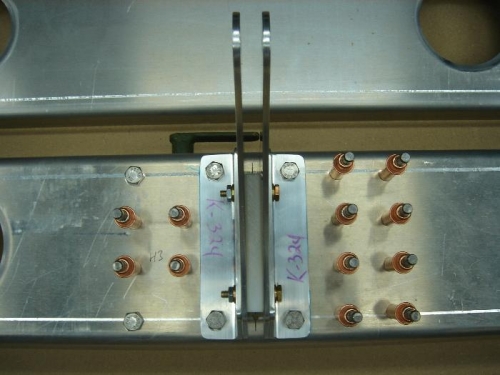

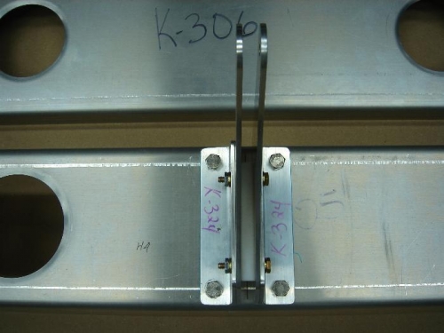

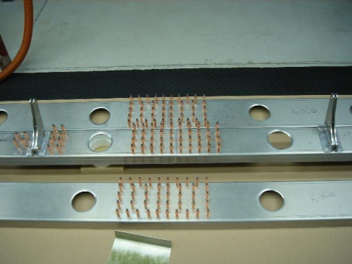

LR Spar Aileron Hinges, Backplate, Bellcrank
Locate, drill, fit, cleco left rear spar and backplates for aileron hinges and bellcrank.K-335, K-334 and K-333/332Rivet Spacing for K-335 (X) 32mm (X) 52mm (X) 76mm (X) 29mm (X) 32mm (X) 52mm (X) 44mm (X) 32mm (X) 29mm (X) 23mm (X) 52mm (X) 44mm (X) 32mm (X) 29mm (X) 32mm (X) 52mm (X) 76mm (X)
