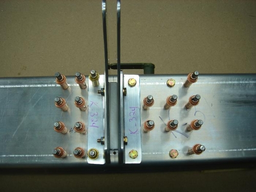

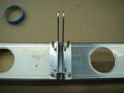

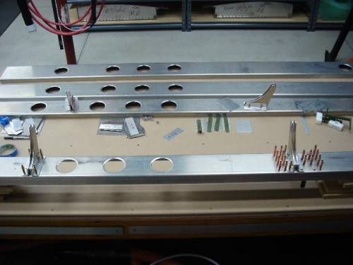

LR Spar Flap Hinges, Backplate, Bellcrank
Locate, drill, fit, cleco left rear spar and backplates for flap hinges and bellcrank.K-335, K-334 and Q-500Rivet Spacing for K-335 (X) 23mm (X) 41mm (X) 96mm (X) 29mm (X) 23mm (X) 41mm (X) 41mm (X) 27.5mm (X) 27.5mm (X) 29mm (X) 23mm (X) 41mm (X) 41mm (X) 27.5mm (X) 27.5mm (X) 29mm (X) 23mm (X) 41mm (X) 96mm (X)
