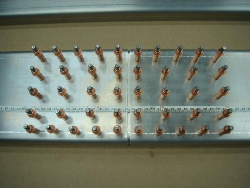

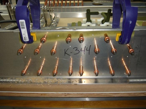

Assemble Left Front Spar Sections
Fit, drill, debure and cleco PK-344, PK-312 and PK-306, verify and adjust lenght of left rear spar.Left Rear Spar 4740 mm (note in photos all measurements start at 100mm)
