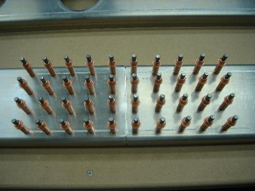

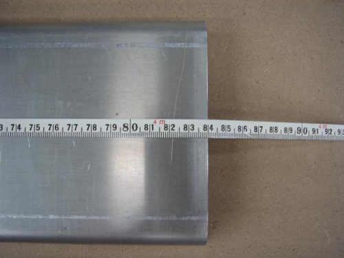

Assemble Left Rear Spar Sections
Fit, drill, debure and cleco PK-343, PK-313 and PK-305, verify and adjust lenght of left rear spar.Left Rear Spar 4740 mm (note in photos all measurements start at 100mm)
