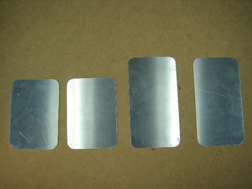

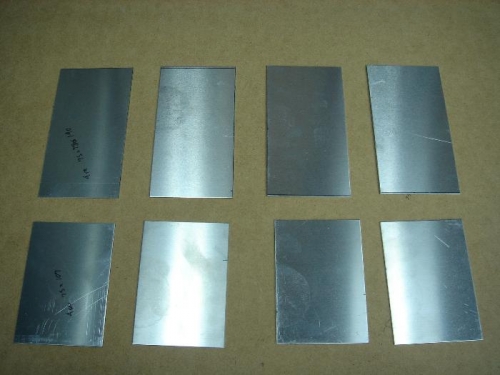

Brief Description:  Cut out doublers for strut support attachments
Went to Aldag Honold and used their shear to cut out 4 - 75mm x 140mm and 4 - 75mm x 107mm from .040 6061-T6 sheet, to be used as doublers to mount wing strut support attachment to wing spares. Rounded corners and debured.
