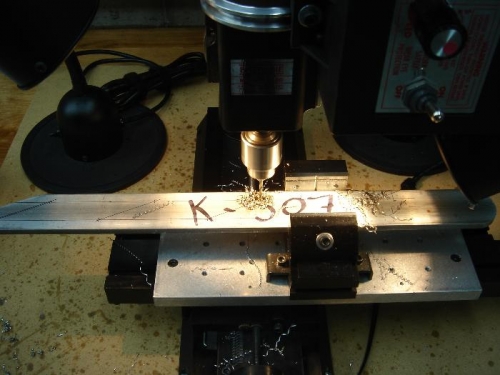

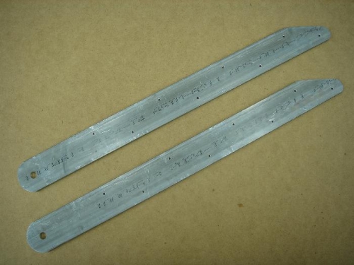

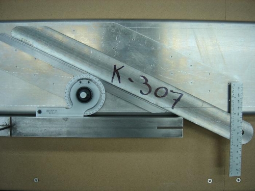

Perpair PK-307 for both Left and Right wings
Locate holes and predrill PK-307s with #40 bit.
