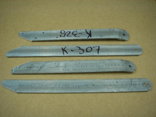

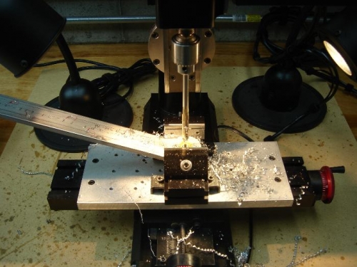

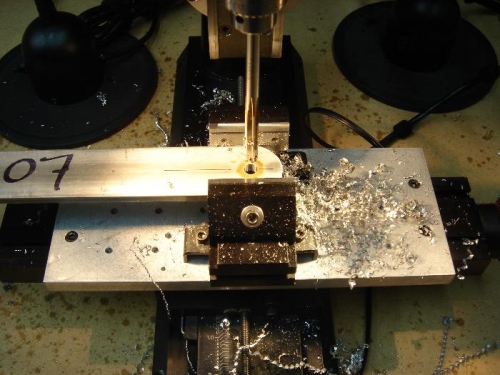

Drill Wing Strut Attach Brackets for Strut Ends
Drilled strut attach brackets PK-325 left and right, PK-307 left and right for struts ends to 5/16" for AN5 bolts. (Reemed to 5/16")
