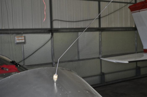

Date:  4-17-2011
Brief Description:  Comm Antenna Install
Selected the comm antenna location and installed. Decided to go with a top mount as opposed to a bottom mount. I'll just have to make sure to gain enough separation between it and the ELT antenna, which I'll place further back on the turtledeck. The ELT manufacturer recommends a three foot separation.
