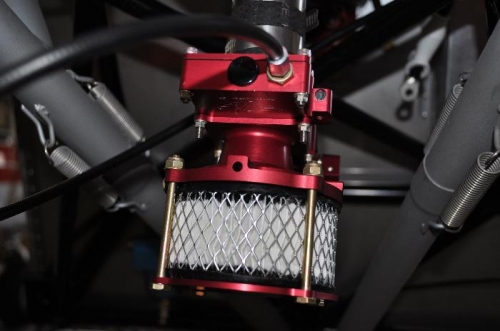

Date:  3-19-2011
Number of Hours:  6.00
Brief Description:  Install Throttle and Mixture Cables
Installed the throttle and mixture cables today. A lot of on and off and pulling through the firewall to get the lengths of each cable to what I think is the right length. I will still have to do some tidying up the routing around the engine to eliminate chaff points and the exhausts, but I'll finish that once the oil cooler is installed.
Mixture cable attached.  I didn't get a picture with both installed.
