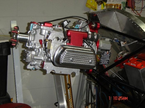

Date:  5-1-2010
Number of Hours:  5.00
Brief Description:  Engine Mounted
Another milestone day. With a lot of help from Karole and our neighbor William we got the engine up onto the mount. Took a little bit of maneuvering but it went onto the mounts relatively easy especially since we did it without an engine lift. I used my garage floor jack and some wood to lift it as close as possible. Scary process because all I could imagine was it falling off the jack and smashing into the floor.

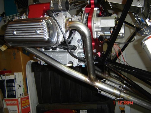

Fitted the exhaust pipes as well. Everything fit really well.
