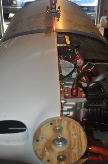

Cowling Fitment
Another tool I found useful in lining up these floppy fiberglass parts was a laser level. I used my centering marks on the canopy and the prop hub to fire the lines on the top and bottom.
Did I mention I hate fiberglass?
