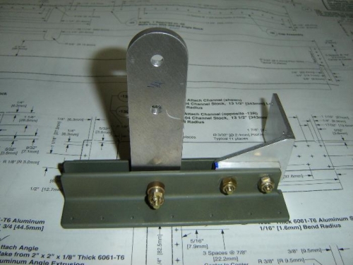

Date:  1-1-2010
Number of Hours:  9.00
Brief Description:  Elevator Bellcrank
Spent most of the day prepping assembling, drilling, up drilling, and fitting the elevator bellcrank assembly. This assembly will mount to the floor between the seat bulkhead and the #1 lower crosstie on the aft fuselage section. It took quite a bit of time to make sure everything stayed in alignment while updrilling and fitting the bronze bushings and keeping it moving smoothly. I was really satisfied with how well it turned out.
Also spent some time making some of the other parts for the cockpit floor and seat attachment.
Will finish priming later before installation.
