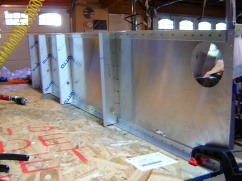

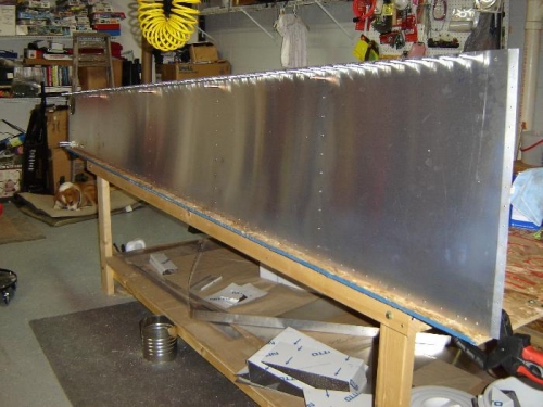

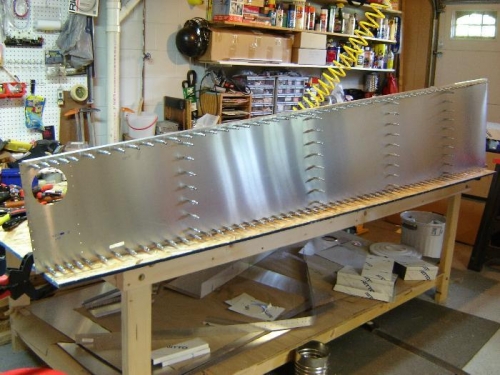

Back to work after the misfortune of last weekend.
Attached the channels to the skin, up-drilled, disassembled, deburred cleaned and riveted the right skin to the lower longeron and channels. The top longeron and upper rivets in the channels are left without rivets at this stage. These will be finished when the turtle deck skin is fitted and isntalled. With the exception of the access cover fittings, this side is complete.
Also fitted and drilled the forward mounting brackets to the longerons. Three of these are pilot drilled only, pending joining the aft section to the forward cabin section later. One of the lower brackets was drilled and is bolted in place.
