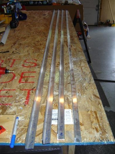

Continued to fabricate the parts for the fuselage sides. The longerons were cut to length and the ends filed to the proper angle. Also cut out the phenolic blocks for the rudder cable fairleads.
Finally, I cut the vertical channels for the left and right sides to length.
Longerons for left and right sides cut and ready to go.

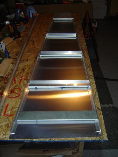

General lay out of the right side with the skin, longerons and channel sections to tie it all together
