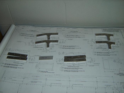

Brief Description:  Finished Left Aileron
Finished the left aileron and temporarily mounted it on the wing. The bolts holding the counterweight had to be removed to allow the arm to fit through the hole in the aft spar. It looks like the bolts will have to be shortened so that they will not contact the wing rib. I'll worry about that later.
Now on to the fuselage construction.
Started fabricating the parts for the fuselage sides. Bent the flat pieces that join the aft fuselage to the cabin section. Also began working on the channel pieces for the sides.
