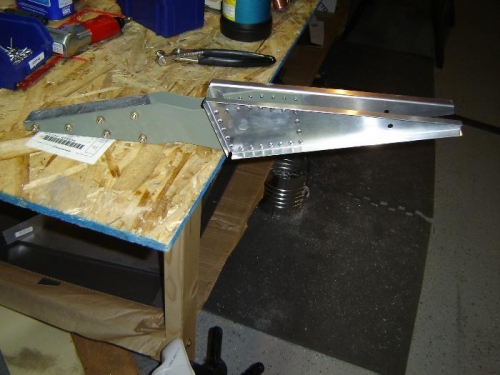

Brief Description:  Prepare Left Aileron Parts
Finished cutting the aileron skin and prepared the ribs for assembly, to include building the counter balance. I used a couple of old drill bits to help align the ribs while assembling the counter balance. It went together really easily and well aligned.
You've got to love these pre-drilled kit parts!
