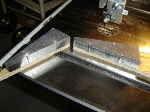

Not much work tonight, but the major accomplishment was getting the aileron balance weights cut out. A single block of 1" thick lead needed to be cut in half to make two mirror images. The new bandsaw handled it like it was cutting though butter. A 6 tpi blade with liberal amounts of Boelube applied. I stopped twice during the cut to re-lube the blade but I think it would have been OK to go through without stopping.
Anyway, they came out looking great.
