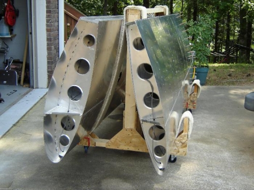

After flipping the wing over I installed the wiring bushings into the nose ribs and ran the position/strobe light wires. Like the left wing I also ran a fish line for later pulling a landing light if I decide to install one.
One more check of the wiring and the pitot/static plumbing then finished riveting the LE skin in place.
Except for fitting the wingtip, the right wing is done.
Right wing complete (except fiberglass tip rib, position light and root doubler).
The Tony Bingellis wing rack is worth the effort. I can roll it with both wings with no assistance. If you are debating whether or not you should build one for your project, do it. You won't regret it.
